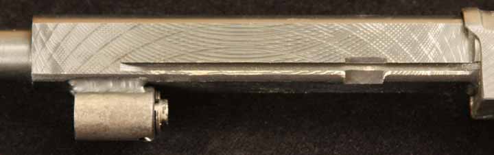

The focus of this post is limited to the gas piston chambers along with the barrel design where they were attached. Most commercial carbine manufacturers did something unique that helps identify their barrels.
Other areas of these barrels sometimes have additional uniqueness but this post is about gas piston chambers.
The Barrel Manufacturers
There have only been a few commercial .30 cal. carbine barrel manufacturers over the years. Only one in the 1960's thru the 1980's. There have been some slight differences so their gas piston areas are shown with the commercial carbine manufacturers who have used them.

Barrels were sold without a gas piston cylinder/housing. Buyers had to, and did, come up with their own. Each commercial carbine manufacturer that used these came up with their own unique design and/or method of attaching them to the barrel. Examples can be found below with Alpine, Bullseye, H&S, Iver Johnson, Millville Ordnance, National Ordnance, Plainfield, Rowen Becker and Universal Firearms

Over time some carbine manufacturers chose to piece together their own barrels using the rear half of demilled GI carbine barrels into which they inserted a cut down 1903A3 barrel or other barrel. The GI swaged gas piston cylinder from the demilled carbine was usually used.
GI Carbine Barrel Gas Piston Cylinders (for reference)
Top: Machined integral to barrel
Bottom: Separate piece swaged on
