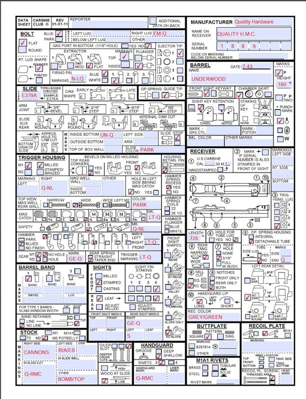

Over the past year, I developed an interest in Garands, which naturally led me to carbines. I came across a Quality Hardware import on another forum, but it was scooped up before I could make a move on it. After doing a bit more reading and searching, this one popped up. Something about it drew me in, I had to have it.
Since picking it up, I replaced the sling and oiler that came with it (both were repros) and swapped out a Winchester handguard for a Q-RMC that I found here on the forum.

Data sheet Looks correct!
Carbine looks good!
BUT - Is that the serial number?
Here is the serial number of one of my carbines 1404 - - -
Seven (7) digits
Is your Carbine 4 digits? or are the other numbers blocked by you?
Thanks Dave StarStar
M1DB

Post Options Post Options   Thanks (0) Thanks(0)   Quote Boz299 Quote  Post ReplyReply Direct Link To This Post Posted: Mar 19 2026 at 5:25pm
The serial is 7 digits 1889---

Boz - Nice Quality Hardware M1 Carbine
Second serial number block (1943)
Great Find!

Post Options Post Options   Thanks (0) Thanks(0)   Quote New2brass Quote  Post ReplyReply Direct Link To This Post Posted: Mar 20 2026 at 2:58pm
Very nice looking carbine!
The stock has been through a rebuild, so not original to the carbine. It also has a post war recoil plate.
The E-379 slide came in a bit later. Other than that your carbine is very close to the COMs 121 and 247.
first is a 1879xxx followed by 1896xxx

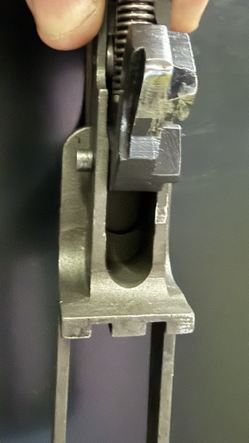

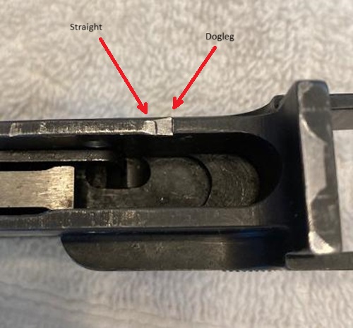

Post Options Post Options   Thanks (0) Thanks(0)   Quote jackp1028 Quote  Post ReplyReply Direct Link To This Post Posted: Mar 20 2026 at 4:02pm
Other than the stock (and the original Winchester handguard that you replaced), everything else looks original. One other thing to check to see if this carbine might have been "put together" is the mark on the trigger housing left by the hammer. If your dogleg hammer is original, we would not expect to see a second mark from a later straight hammer. Here's a picture of what I mean.

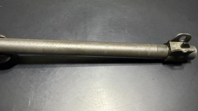

Well, excuse me! I will return to my slumber now.
Oh, it dawned on my as to if there's another proof P on the barrel other than the UEF one that's shown.
Post Options Post Options   Thanks (0) Thanks(0)   Quote painter777 Quote  Post ReplyReply Direct Link To This Post Posted: Mar 22 2026 at 12:31pm
How is it known the stock isn't original to this action?

Post Options Post Options   Thanks (0) Thanks(0)   Quote HARLEY08 Quote  Post ReplyReply Direct Link To This Post Posted: Mar 22 2026 at 1:20pm
Data Sheet has M2 stock checked -
Please correct that!

Post Options Post Options   Thanks (0) Thanks(0)   Quote New2brass Quote  Post ReplyReply Direct Link To This Post Posted: Mar 22 2026 at 1:51pm

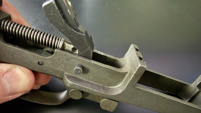

Post Options Post Options   Thanks (0) Thanks(0)   Quote jackp1028 Quote  Post ReplyReply Direct Link To This Post Posted: Mar 22 2026 at 2:55pm
@Harley, I believe I see a M2 selector cutout in the OP's third picture. I believe this might be a Type IV (M2) stock. Here's an edited pic that highlights that cutout. More pictures would be helpful.

Post Options Post Options   Thanks (0) Thanks(0)   Quote Boz299 Quote  Post ReplyReply Direct Link To This Post Posted: Mar 22 2026 at 3:10pm
Jack, learn something new here everyday. Here are a few more pictures.

Post Options Post Options   Thanks (0) Thanks(0)   Quote New2brass Quote  Post ReplyReply Direct Link To This Post Posted: Mar 22 2026 at 4:49pm
John, Is it possible the original stock was sporterized or broken, and a previous owner got a correct stock that been though rebuild and put on?
@Boz, can you check the barrel for a second "P". A pic of the mid section of the top of the barrel would help.
Front sight looks like the stamped and brazed type, any markings? Look at all sides including the front and inside the wings.

Post Options Post Options   Thanks (0) Thanks(0)   Quote Boz299 Quote  Post ReplyReply Direct Link To This Post Posted: Mar 22 2026 at 5:39pm
Single P on the barrel and looked at the front sight under magnafication and it has no markings.
Post Options Post Options   Thanks (0) Thanks(0)   Quote jackp1028 Quote  Post ReplyReply Direct Link To This Post Posted: Mar 22 2026 at 6:59pm
The QMHC barrel proof is one of the few that is fairly easy to identify. On all other carbine barrels that use a "P" proof, the leg on the "P" is about the same length as the upper encircled portion. Some have serifs, some don't. NPM uses a simple punch mark and WRA uses their stylized "WP" logo. (See CCNL 384-20)
However, the QHMC "P" proof has a noticeably shorter leg than the others. See the sketch below.

Post Options Post Options   Thanks (0) Thanks(0)   Quote HARLEY08 Quote  Post ReplyReply Direct Link To This Post Posted: Mar 22 2026 at 7:05pm
Wow - M2 stock must have been changed sometime.
